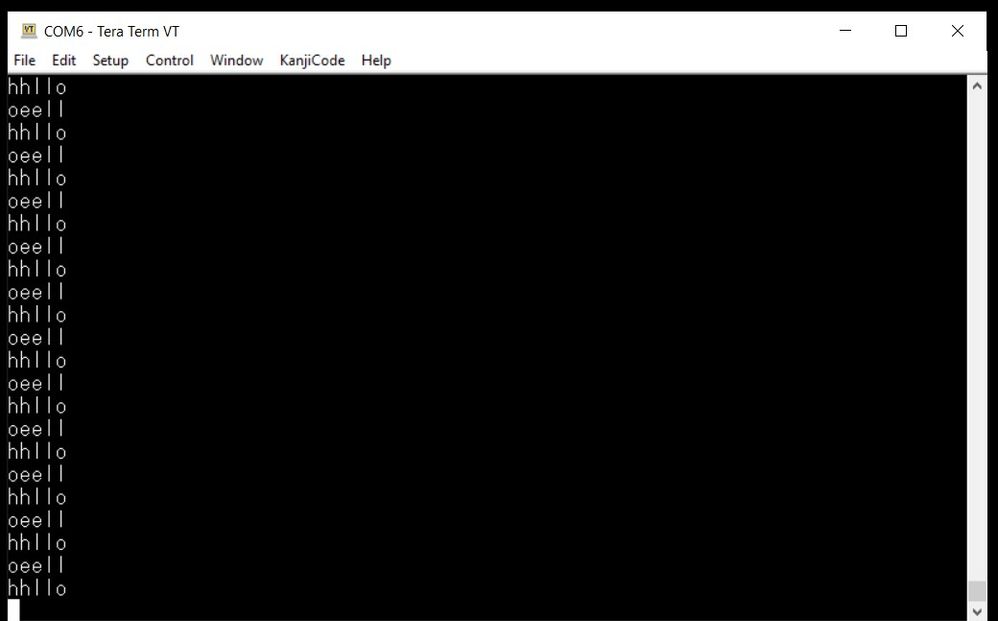

I try to send "hello" from slave and this is what I am getting on master:
It's not perfect, there are repeated as well as alternate characters.
I am sharing the codes for master and slave, which are quite long, but the main function might be the only thing to looked at.

Since on the scope, I am getting the data on MISO line correctly, I suspect my method of storing data on master side is the flawed one.
How do I deal with this?
2020-04-06 1:11 AM
buff[i] = *(__IO uint8_t *)&SPI1->DR; //store MISO data in buff
See Data packing section in SPI chapter in RM. You have used it for Tx...

2020-04-06 1:26 AM
Thank you so much. You pointed reading Data packing last time too, but I didn't, sorry. And as you pointed, yeah I forgot the casting. My bad. :grinning_face_with_sweat:
