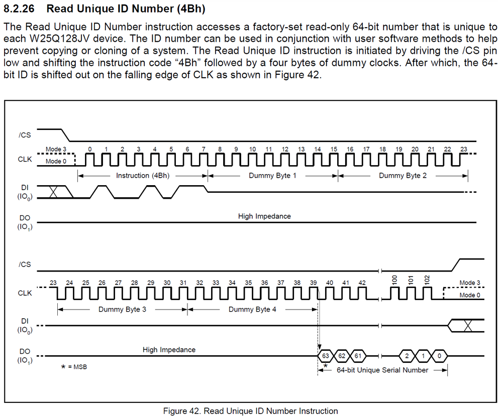

The datasheet provides all you need to know.
If you don't know how to use SPI, well that is a different question. Look for an example that uses HAL_SPI_TransmitReceive in the CubeMX repository.
