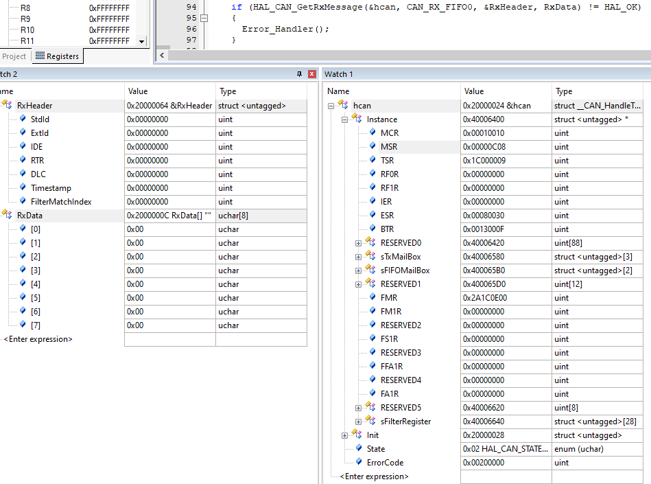

Any help? I am reading can and getting all zeros when connected to car CAN bus. Why could I get zeroes?0690X00000Buc42QAB.png

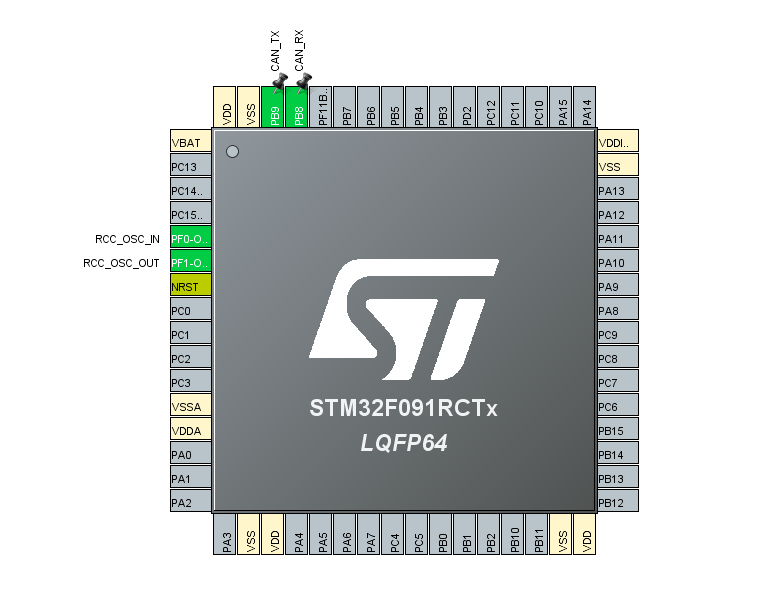

I have connected transreceviver to PB8 and PB9.

#define HAL_CAN_ERROR_PARAM          (0x00200000U) /*!< Parameter error
As I understand I am getting this error. What does this error mean and how to fix it?
