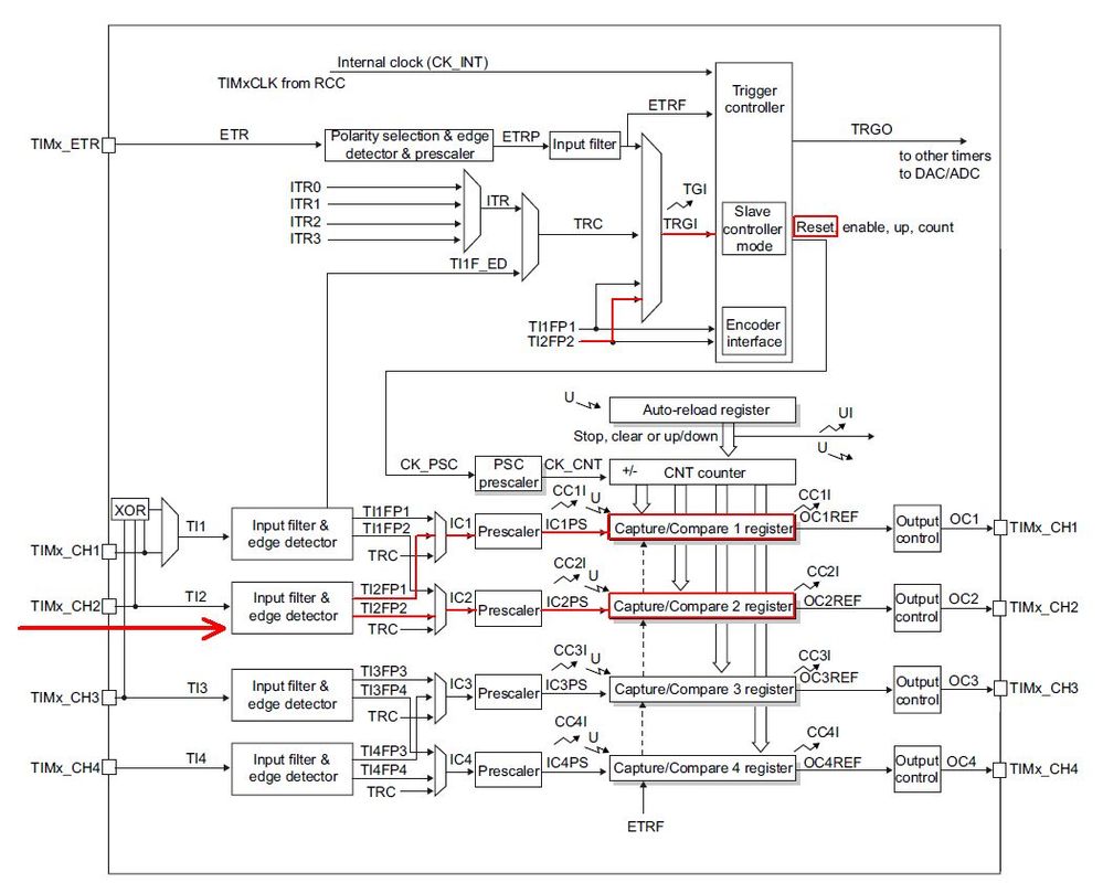

You can use timer in 'PWM input mode'. Configure timer to reset with rising edge and to capture time with falling edge of your signal. Configure timer to generate DMA request with capture event. It creates only one time stamp for one pulse. Probably there will be some 'delay' in timer reset, like one or two cycles, but it will be negligible error if you want distinguish 1 and 2.6us pulses.

It's probably wrong timer configuration. May be some image can help - this is one configuration fo ''PWM input capture'':
icinit.TIM_Channel = TIM_Channel_2; icinit.TIM_ICFilter = 0x0; icinit.TIM_ICPolarity = TIM_ICPolarity_Rising; icinit.TIM_ICPrescaler = TIM_ICPSC_DIV1; icinit.TIM_ICSelection = TIM_ICSelection_DirectTI; // TI2FP2 TIM_ICInit(TIM3, &icinit);
icinit.TIM_Channel = TIM_Channel_1; icinit.TIM_ICFilter = 0x0; icinit.TIM_ICPolarity = TIM_ICPolarity_Falling; icinit.TIM_ICPrescaler = TIM_ICPSC_DIV1; icinit.TIM_ICSelection = TIM_ICSelection_IndirectTI; // signal from channel 2 (TI2FP1) TIM_ICInit(TIM3, &icinit);
TIM_SelectInputTrigger(TIM3,TIM_TS_TI2FP2); // Event for Reset Controller from rising edge TIM_SelectSlaveMode(TIM3,TIM_SlaveMode_Reset); // Reset timer with that event
next configure DMA to transfer data from Capture 1 register to memory (i think you want use circular mode). Enable DMA ''transfer complete'' interrupt (which will indicate that burst is over and collected data waits for you). Enable DMA request in timer (request from Capture1 event).There will be one more problem with enabling timer. You must do it in ''pause'' between pulse bursts. Bursts have to be separated by some time (roughly more then ~5-10us). You can identify this ''pause'' by few clever or stupid ways. Stupid (but sufficient) one is:
1. init, but not start, some timer (TIM6 for example)2. wait for falling edge at line (wait for log.1 then wait for log.0)3. (re)start that timer (TIM6)4. wait until timer counts to ~5us or to falling edge, if falling edge comes soon, go to point 3.5. if your timer counts to 5us without detecting next falling edge, you are in ''pause'' time and you can start main timer (TIM3 in this example). If you are worry that two bursts can rarely comes without sufficient ''pause'' you can set up DMA to take 8 values and enable also ''half transfer'' interrupt. Then you can processing old data and capturing new in same time.2018-03-20 6:30 AM

1) Cubemx does not allow for selecting TI2FP2 as a trigger. Only TI1FP1. Nor does it allow for setting channel 2 for Direct mode. I have tried this on TIM2 and TIM15 and TIM3.
2) I set up the timers manually ignoring what cubemx generates and found that I could not get TI2FP2 to trigger a timer reset. TI1FP1 works on the rising or falling edge as expected.
Is this a limitation with HAL drivers? The timers limitations on this MCU ( tried a stm32f302 as well)?
EDIT : I can select these setting by using channel two as the pwm input but then I cannot set up a dma request from channel one through cubemx. I only allows adding a channel two dma request.
