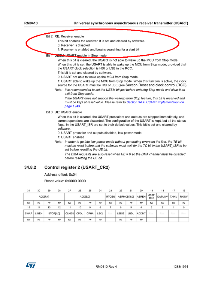

2021-07-22 3:48 AM
2021-07-22 4:00 AM

2021-07-22 6:43 AM
It is a wild idea, but I think that sending more chars will just cause more crosstalk and echos... I think the easiest solution is not receive, while transmitting...
Regards.
2021-07-22 6:43 AM
thanks for the tip. I'll check and implement it...
Regards.

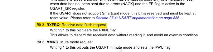

2021-08-02 5:10 AM
In case you want to restart reception with a clean (empty) Rx content (and discard a data that might have been received prior you disable/enable RE), you could also flush the RX path by writing 1 in RXFRQ bit in USART_RQR register.
Regards
