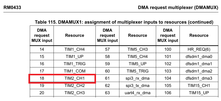

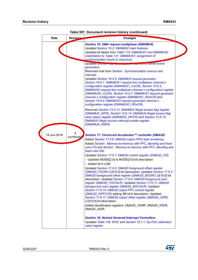

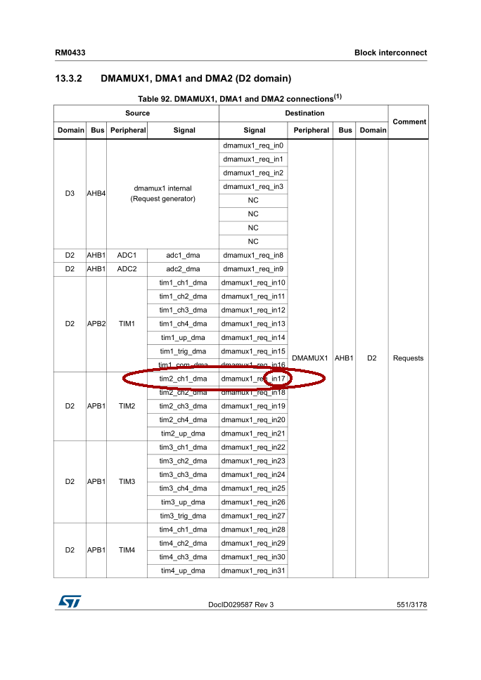

2018-08-07 1:04 AM
(RM0433 Reference manual STM32H743/753 advanced ARM ® -based 32-bit MCUs) 4th Revision (but it's looks like your document is different from mine, i should look into it too)
I'm totally agree about magic numbers but this is some kind of testing\fluent code I just poke into registers and trying to understand documentation.
The most interesting thing that there are few another question about dmamux configuration (one from stackoverflow, another from local resource) and none of them were answered.
