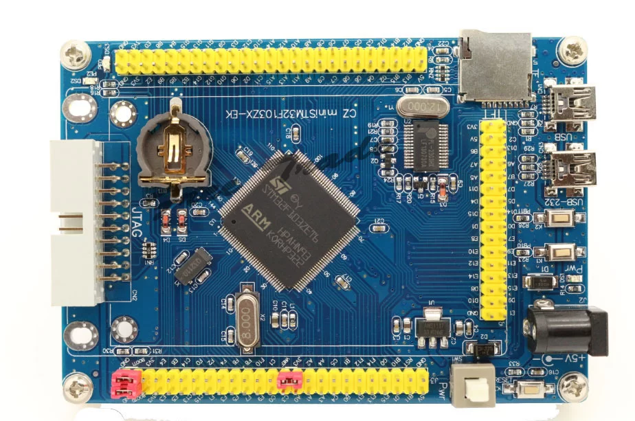

This is the board picture:
I bought it from Aliexpress, I tried to connect it to Arduino IDE but didn't connect.
There are two boot pins, how to use them ? What should I do exactly ?

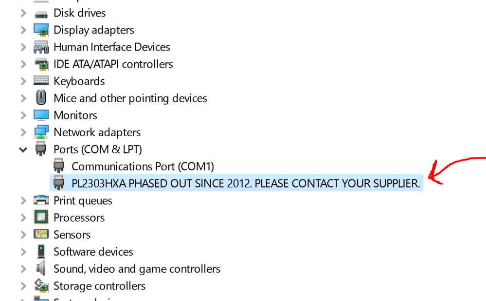

On the device manager, it displays this message:

On the F1 with BOOT0=1, BOOT1=0 you should be able to get a USB device on the primary USB connection. For there USB/DFU mode on STM32 Cube Programmer
2022-01-18 11:02 PM

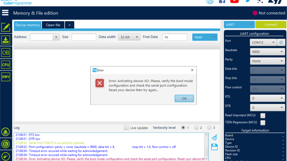

With BOOT0 low you should be able to connect and program via STM32 Cube Programmer in COM port UART mode.
Alternatively get an ST-LINK and connect via the 20-pin JTAG connector.

I tried but I couldn't, I pulled boot0 to GND.
I get this message:

Update:
I found this video which solved the driver issue.
Now the board is displayed correctly in the device manager.

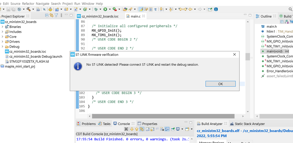

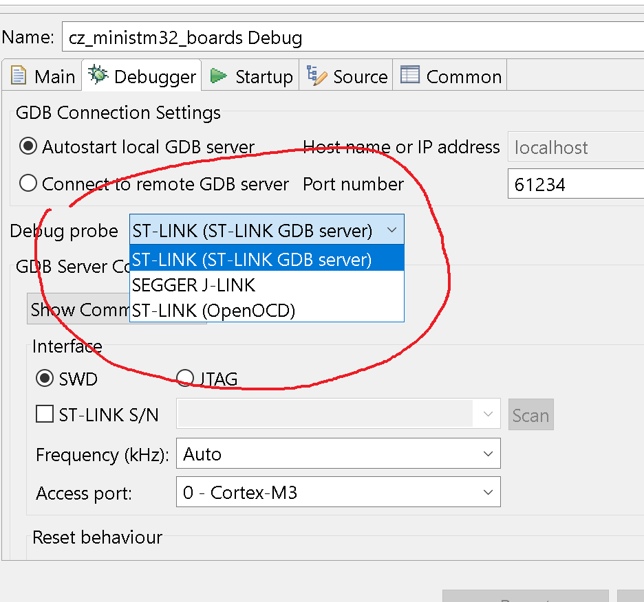

Also in regard to the Cube IDE, I can't use the serial connection as the methods requires external programmers.
2022-01-19 8:34 AM
Right you DON'T have an ST-LINK, you're not going to be able to interactively do debugging and downloading from the IDE without one, or another JTAG/SWD pod

I installed the software, but I got this error, with setting boot0 to GND.

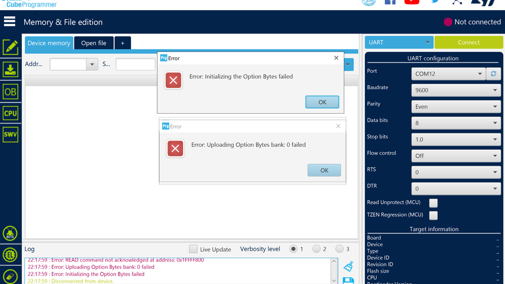

2022-01-19 11:19 AM
Setting boot1 to GND I got this:
