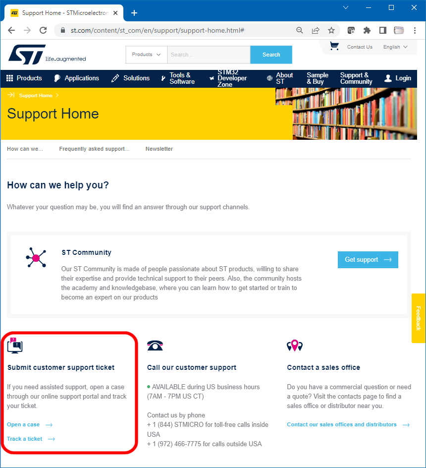

2022-06-16 3:07 AM
As @Community member said, you'll likely need to go direct to ST or your FAE for specific details of unpublished info like this.
