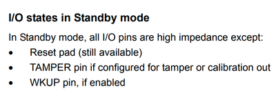

I am using stm32f302r8t6 microcontroller. In standby mode, the pins on port A are high, which should not be the case for the card I designed. For the stm32f302r8t6 microcontroller, I should keep one pin on port A low in standby mode.
2023-10-24 10:04 AM
In standby mode, almost all pins are high impedance. You need an external resistor to give the pin a defined state when in standby mode.
If it's the WKUP pin, you can configure it to have a pulldown.

Is there any way I can keep the a11 and a12 pin low? without making any hardware changes
for microcontroller stm32f302r8t6
Thank you for your answer..
2023-10-25 7:08 AM
They aren't WKUP pins, so no.
