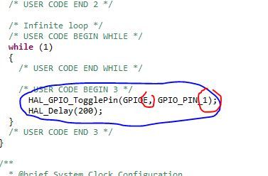

I've been trying to make LED blink. GPIO PE1. So i wrote this code:
HAL_GPIO_TogglePin(GPIOE, GPIO_PIN_1);
HAL_Delay(200);

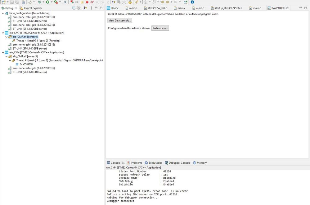

When i try to debug CM4 whitout any code exept generated one, it stops at: _HAL_RCC_HSEM_CLK_ENABLE(); when i hit play im receivng: Break at address "0xa05f0000" with no debug information available, or outside of program code.

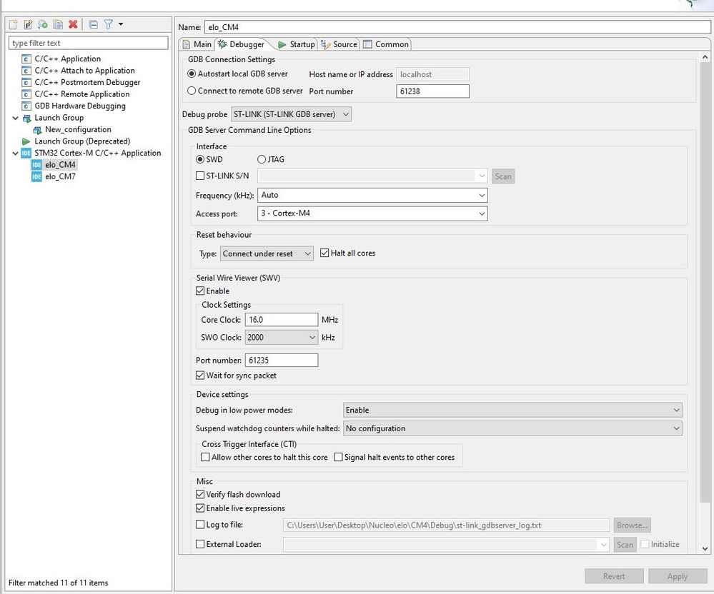

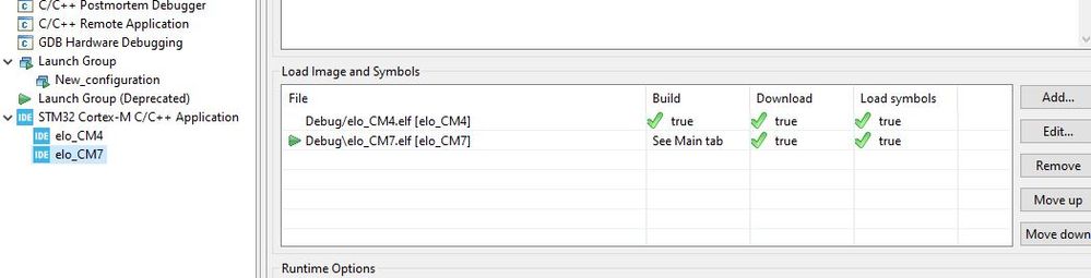

I will check clock tab in MX section but i'm not sure if i know how to do it. can you give me a hint? I've found papper from ST "Getting started with dual-core STM's, AN5361, Nucleo-H745ZI-Q is an example there but i'm stil missing something. So i need to set debug configuration properly for CM7 and CM4 but i dont know if it is a "BOOT_CM4 and BOOT_CM7 option bytes" i've mentioned. Can you give me a hint where should I look for those options? Do i need to write any more code manualy?
Thank You
EDIT:

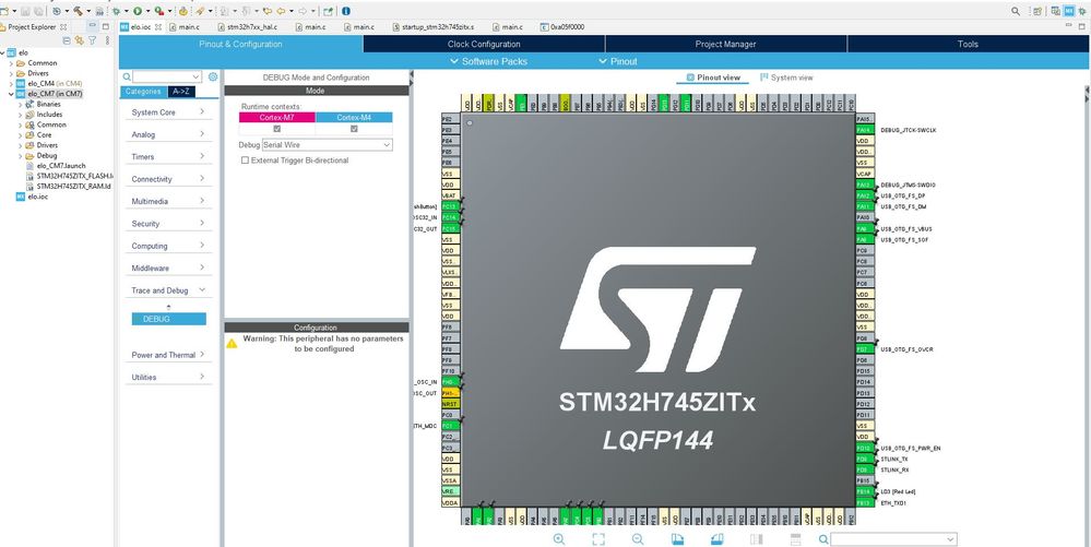

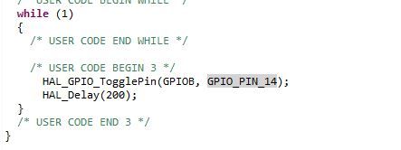

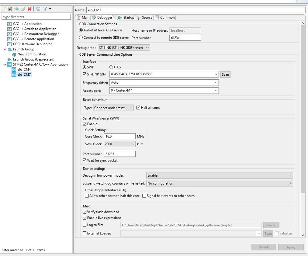

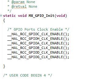

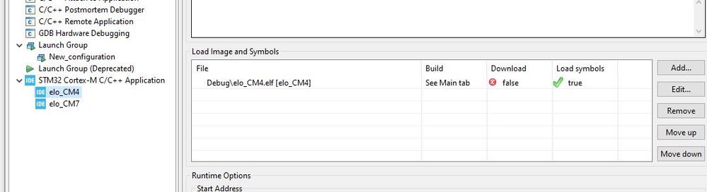

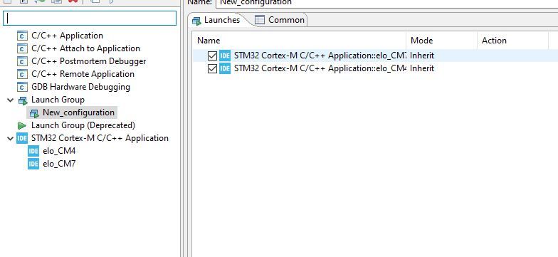

I've been trying to make it work for some time. Can you look at those screenshots from CubeIDE? Maybe you will find something out of order. Code is from CM7 main.c i didn't change anything in CM4 main.c.
2021-01-05 5:49 AM
It doesn't look like the GPIOE clock is enabled. There needs to be a call to __HAL_RCC_GPIOE_CLK_ENABLE() prior to using those pins. It is enabled for other ports, but not GPIOE.

> But GPIOB is enabled and still its not working.
Please read carefully: The LED is on GPIOE, not GPIOB. Which clock do you think needs enabled?
Good luck.
If you assign the pin as output and assign its context to the M7 core, it will initialize it for you during CubeMX code generation. Otherwise you need to do it yourself.
