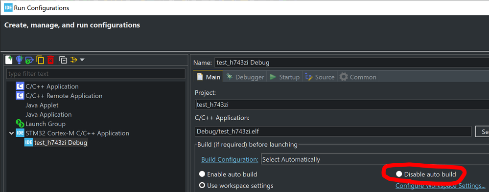

A) In Debug (or Run) configuration, you may disable autobuilding here:
To start a debug session without re-downloading it:
Go to Debug Configurations... -> Startup -> select load image -> Edit... -> uncheck Download

> when I stop debugging, it seems there is no other choice but to recompile.
Even if you select in debugger settings DISABLE auto build?
Hansel
Senior
@TDK​, @Pavel A.​, thanks for your help. Disabling auto build helped avoid reflashing if the code hasn't changed. Thanks a bunch.
