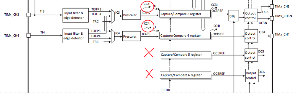

I just started porting a project over to STM32. It does some complex stuff with timers. First I found out the the HAL doesn't support my usage of one pulse mode in timers. So I went for the LL API which I liked on first sight.
Now I found out that the LL API only implements 4 of 6 capture compare channels of the advanced timer 1 of STM32F3xx.
I need at least 5 CC channels. What can I do to get the rest of the CC channels?
I started adding the missing functions and constants but I suppose I won't get it to run because I also need the corresponding interrupts and other functionality so I will probalby hit something not implemented in C.

The channel 5 and 6 do not have an interruption or DMA request.
And about the status register TIMx_SR, the bit of this register is set when the counter matches the corresponding compare value even if the interruption is disabled.

You did not tell us exactly which STM32F3xx you use, so I just looked at the TIM1/TIM8/TIM20 chapter of RM0316 Rev.8, and noticed, that there are no *interrupt enable flags* for channels 5 and 6 mentioned in TIMx_DIER , although there are respective *interrupt flags* in TIMx_SR (CC5IF and CC6IF).
I don't have a 'F3xx at hand to try now, but it may as well mean that these channels can't trigger an interrupt.

You are right. There are some registers missing. So the last two CC channels are almost useless. What a pitty. :(

It's a pity they don't. I also don't get the purpose of OC6 (i.e. the output control unit of channel 6), and in TIM20, also OC5...
