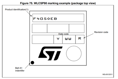

The information needed by the user is provided in the datasheet:
We don't provide detailed explanation. And the two chips are genuine.
Many new chips have 2D QR code marking. for more details you can contact your local FAE/Sales.

Thank you for the response. I have already reviewed the datasheet and understand how to read the date/time information printed on the chips.
However, I have a specific question regarding the markings:
What do these specific codes represent?
The reason I am asking is that I am using both chips in the same circuit and with identical code, but I am observing a difference in the Ethernet functionality:
Could you please explain why there is this difference? Are the markings related to internal revisions or production variations that affect Ethernet compatibility?
