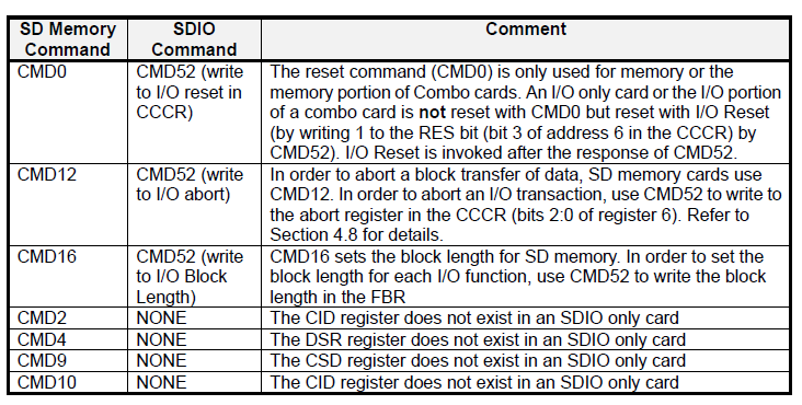

SDIO Simplified specification:
2020-05-24 8:21 PM
You're right.
You'll have to create your own function as this command isn't in the HAL library. You can use SDMMC_CmdStopTransfer function as a template and change CmdIndex to 52 and change Argument to set the correct bits. However, it looks like the response is R5, which doesn't appear to be supported by HAL either--there doesn't appear to be a SDMMC_GetCmdResp5 function. You'd have to create this as well.
So short answer, do it yourself or wait until it's implemented into HAL, if ever.
