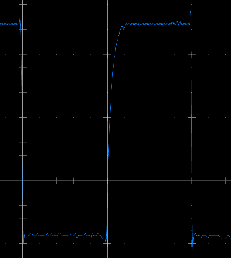

}Here's my signal (5us/div):
99.6KHz, accurate enough for what I need.
But why do I need to add 19 to the CNT? This is the time lost somewhere, is it between the timer reaching zero and interrupt triggered? Does it take 1.95us?

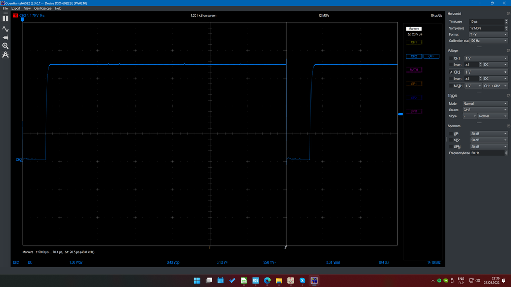

It takes exactly 1.93us to compensate for the interrupt delay. However, the signal on the scope looks exactly as it should look. It's generated in a loop and I tried to swipe the touch screen to introduce some interrupts - no visible change in behavior except very small, negligible jitter.
Anyway, I wonder if that kind of code would work... I don't have a free UART, but I need 1-Wire. The only option left is bit-banging. Probably the only way to do bit-banging without hitting other threads too hard is just use the timer interrupt.
