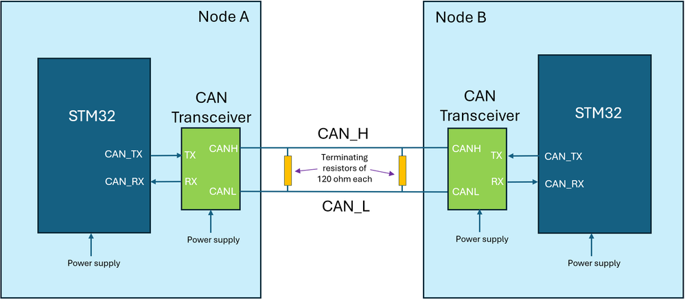

This is the minimum hardware required to establish a CAN bus:
You need at least another node on the bus for the acknowledgement mechanism. CAN is not UART or SPI to use it in stand alone.
Use External loopback mode instead, where you can use one node in stand alone and monitor the Tx pin.
