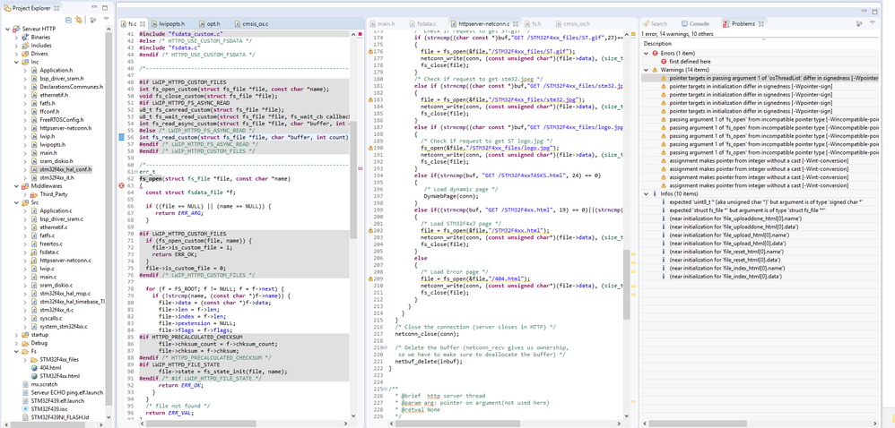

KI am using LWIP , STM32F4 and I want to iimplement an http web based on netconn API in the board.
I activated httpd from CubMX, I downloaded makefsdata.exe from internet and I generated with it the fsdata.c file..
In the fs.c generated by CubMX there is error in the fnction fs_open
in the programm of the http I am using I wrote this
file = fs_open(''/STM32F4xx_files/stm32.jpg'');
In fs.c file
err_t
fs_open(struct fs_file *file, const char *name){const struct fsdata_file *f;if ((file == NULL) || (name == NULL)) {
return ERR_ARG;}I did not understand the error exactly
You will find attached the capture of the error and the programm
thank you in advance for your help

If you read the LwIP documentation, you will find that you have to write your own custom fs_open to do what you want to do

Indeed in this htppd.c usage of fs_open is inconsistent.
If this code comes from some 'static' template, need to fix it.
Or, get updated sources from the home site of LwIP project.
-- pa

Yes I corrected it like this
struct netbuf *inbuf;
err_t recv_err; char* buf; u16_t buflen; struct fs_file * file;....
/* Check if request to get ST.gif */
if (strncmp((char const *)buf,'GET /STM32F4xx_files/ST.gif',27)==0) { recv_err = fs_open(file,'/STM32F4xx_files/ST.gif'); netconn_write(conn, (const unsigned char*)(file->data), (size_t)file->len, NETCONN_NOCOPY); fs_close(file); }But i get a warning sayin ' file may be used unitialized in this function .wht does this mean ?? it is declared u nthe begining of the function
Thank you for help
2018-05-28 5:45 AM
I got error sayin Passing argument 1 of 'fs_open' from incompatible pointer type
2018-05-28 5:46 AM
and info saying '' expected 'struct fs_file*' but argument is of type 'struct fs_file**'
what does this mean please ?
2018-05-28 6:01 AM
so what I wrote is correct ?
struct fs_file *file;
recv_err = fs_open ( fichier, '/ STM32F4xx_files / ST.gif');
but I have the same warning sayin file may be used uninitialized in this function

I meant file and not fichier
is it correct ?? how can I correct it please !!?
