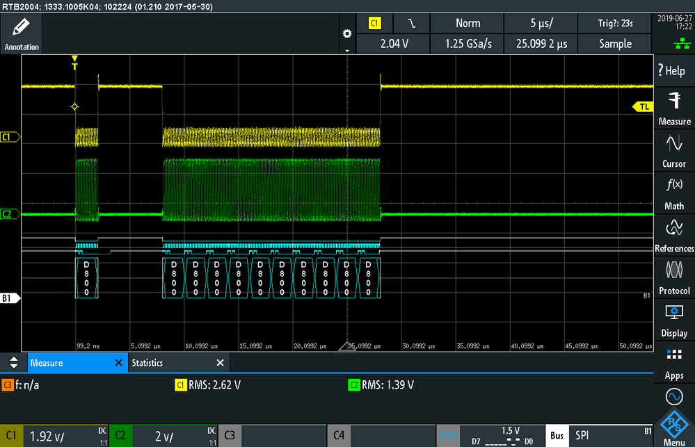

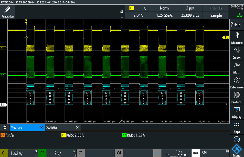

In the next picture NSS in Yellow and SCK in green, this is the required pattern, I get it when sending data one by one
and in the next picture 1st half word is sent in one command and after that I start DMA,
you can see that NSS is kept low during the whole data transmission

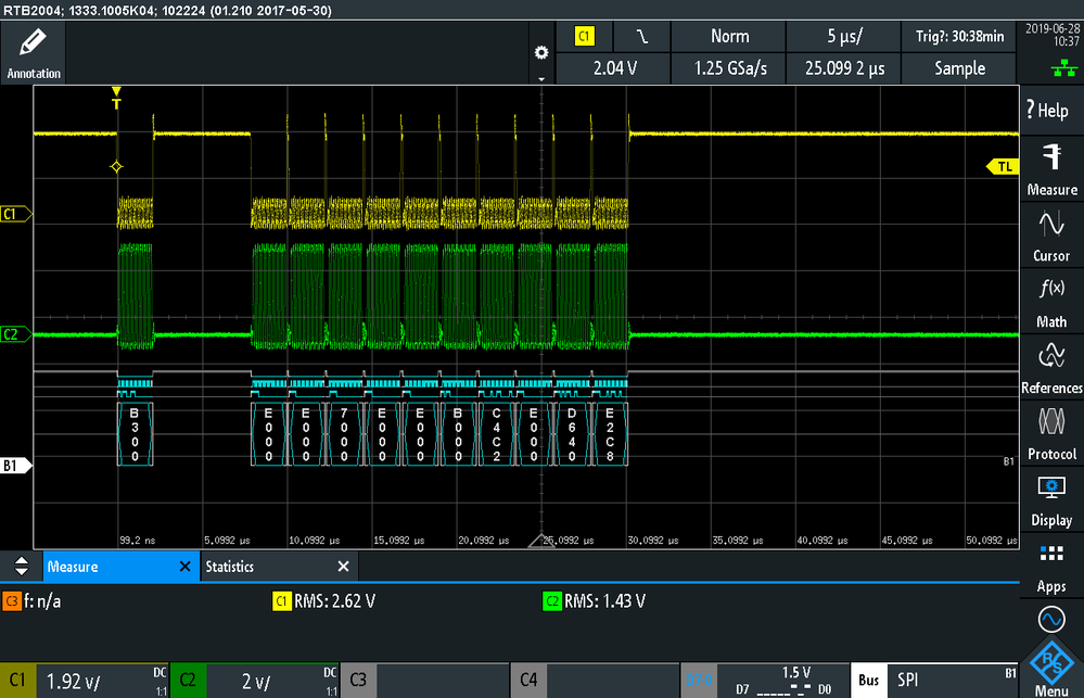

2019-06-28 1:30 AM
thanks @Community member
it was the MIDI, I should use a value greater than 1
Here's the working configurations

Set nonzero SPI_CFG2.MIDI, read Slave select (SS) pin management subchapter of the SPI chapter in RM.
