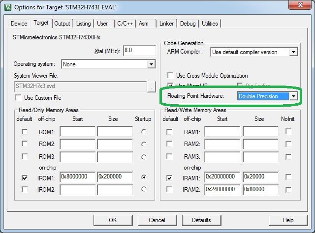

Usually it is a check-box item in the IDE, in Keil you select in the target options.
Compilers typically take it as a command line option or define.
There are defines you can look for, and you can check the co-processor register in the SCB

Do these tools not have a manual?
Go look under the project or compiler settings,
MCU Settings->Floating Point Hardware
