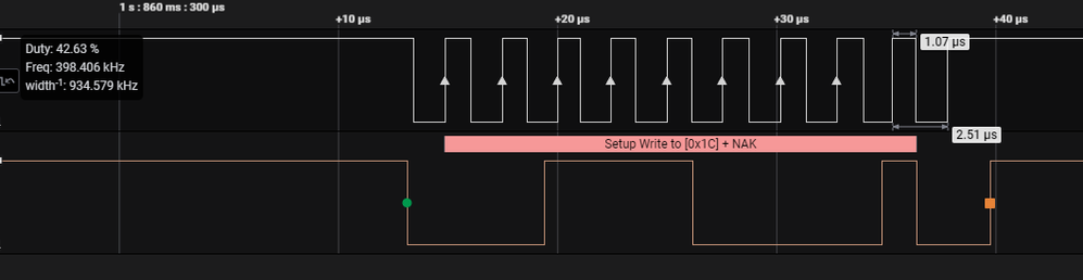

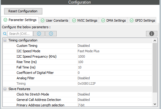

0693W00000NqrMkQAJ.pngI'm trying to configure the I2C to run at 1Mhz(Fm+) on STM32L496. As per the RM0351, it does support fast mode plus mode. I tried generating the code from STM32Cube IDE and check the SCL pin of logic analyzer. However, I see 400 khz I2C clock frequency. How do I achieve 1Mhz I2C clock?
Configurations:
I2C peripheral: I2C2
I2C clock source: SYSCLK
SYSCLK freq: 80Mhz
Code generated:

  I2C_InitStruct.Timing = 0x00B0122F;

However, I see only 400khz on logic analyzer. Can someone help where I might be getting it wrong?

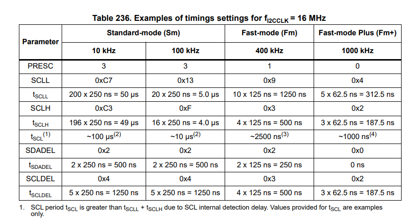

In the RM0351 there is an example configuration of working 1MHz timing settings with 16MHz peripheral clock.

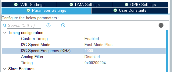

As per your recommendation, I tried to replicate the settings shared in RM0351 for Fm+ mode. However, I still see the same behavior.
0693W00000NqzSRQAZ.pngI2C clock source set to HSI clock running at 16Mhz.
Based on the values in the table above:
PRESC = 0x0
SCLL = 0x4
SCLH = 0x2
SDADEL = 0x0
SCLDEL = 0x2
This values the timing register value as 0x00200204
I set this as custom timing in the CubeIDE however the behaviour is still the same.
