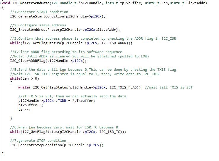

I need some guide on how to do the basic master send data to the slave for i2c. The question is, I need to send some data to the slave with address 0x68. Unfortunately, my start condition could not be SET and I do not know why.

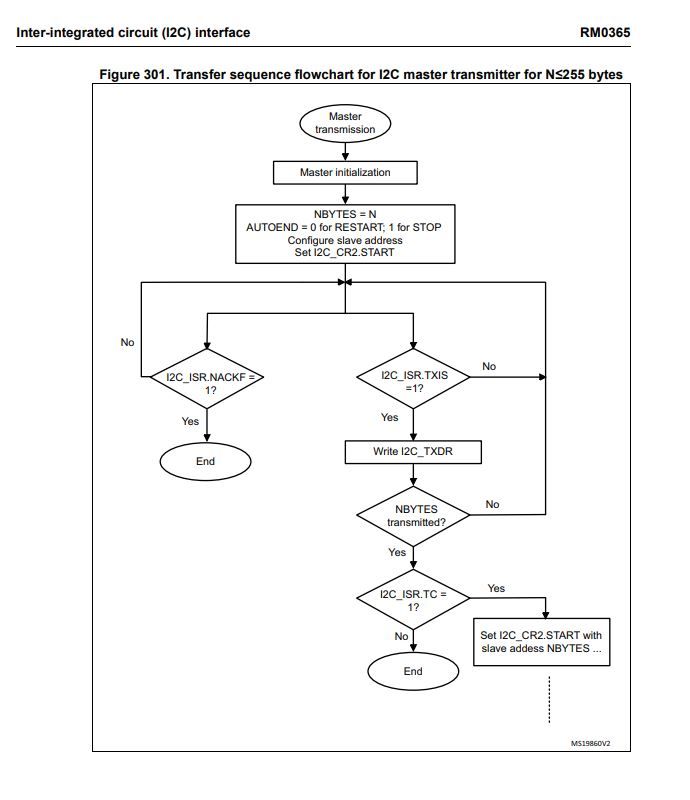

here is the flow chart for basic master send data for my mcu:
Here is my existing code that is not working:
I hope someone can give me a clear explaination and method on what is the step by step code function that I need to write in order to get the basic master send data

Hi @WM_IR ,
Several examples are already available under STM32CubeF3/Projects/STM32F302R8-Nucleo/Examples/I2C at master · STMicroelectronics/STM32CubeF3 · GitHub.
Try to to look to the more suitable example in your case and adapt it on your need (updating the slave address for example or used pins …).
-Amel
