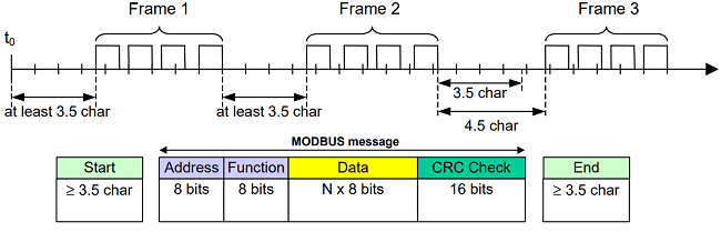

MODBUS RTU frame start and end with >=3.5 char interval i want to detect this interval using stm32 uart interrupt after detection of frame and i can process data further.
How can i detect this silent char interval using uart interrupt or any other way to do this?
