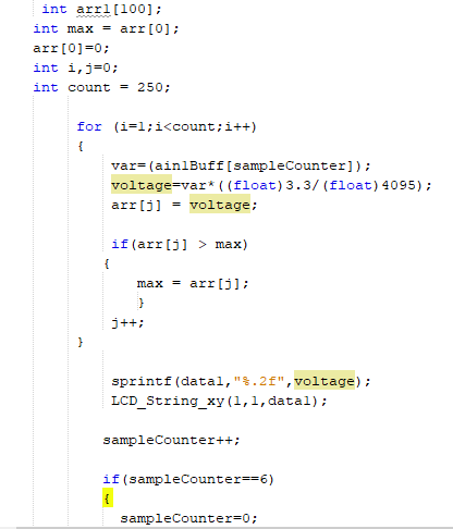

I have connected a sine wave of amplitude 3V with 1.5V shifted above the zero to 12-bit ADC channel by using dsPIC33FJ32MC204 controller and stored in an array. I want to detect the max value out of five samples because after the five samples my data is repeating, so please give me any suggestion on it. I am getting output as a zero.

@sanju Thanks for your reply sir. I have to detect max value in both cases (i<arrayLength & i == arrayLength ),but in one condition i.e i<arrayLength max value detection is missing. And another thing is can i replace the whole code by writing the code like-
array[i] =adc_value;
for(i=0;i<8;i++)
if(array[i] > max)
max = array[i];
sprintf(data1,"%.2f",max);
LCD_String_xy(1,1,data1);
max=0;
if(i == 8)
i = 0;

@sanju I got your point sir but once j becomes greater than 8,it will never goes in for loop and my data is real time data, so I have to do it continuously. I think instead of i = 0, it should be j = 0 ?
