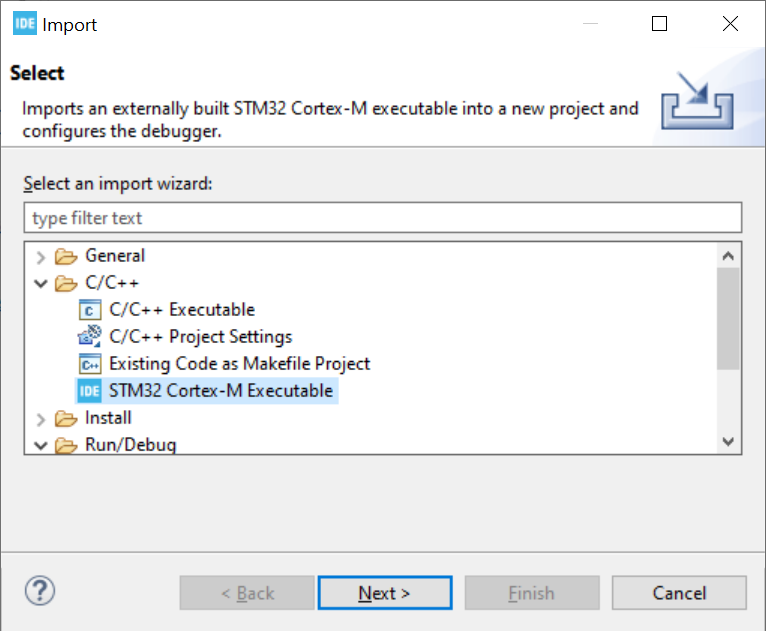

How to do this? Here is a small guide:
Step1: In CubeIDE click: File > Import > C/C++ > STM32 Cortex-M Executable

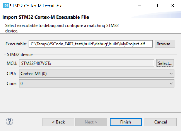

Step2: Point to the elf-file of the VS Code managed project. Select the MCU/CPU/Core

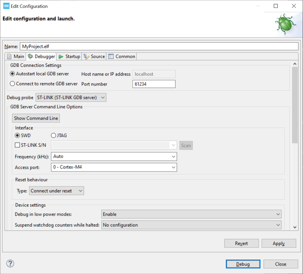

Step3: Generate the debug configuration. Possibly enable RTOS-debug or tracing, or whatever...
Step4: Click Debug! Now you are in the debugger.
The elf-file contains all the symbol information needed to do source code level stepping. No need to manually configure anything else to have a full-blown debug session going.

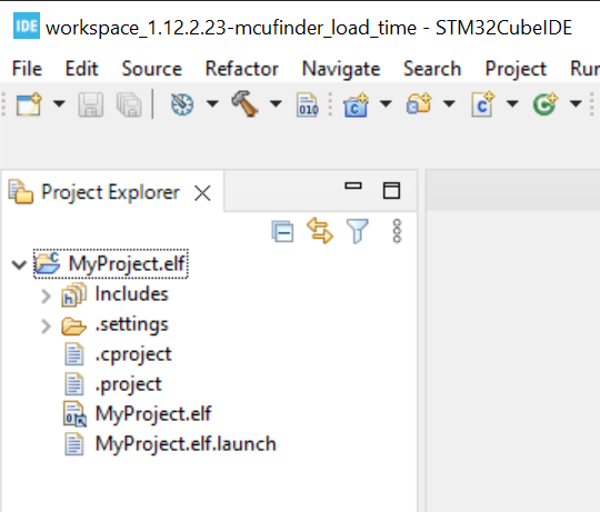

The project inside STM32CubeIDE looks like this:
It just creates the required .project/.cproject files and some .launch-files to keep everythin together but no source code. You can keep this project at a separate location then the VSCode project if you want. It all depends on where you choose to open your STM32CubeIDE workspace...
