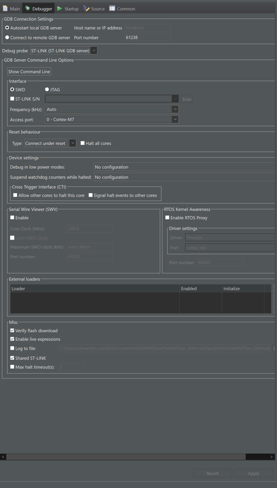

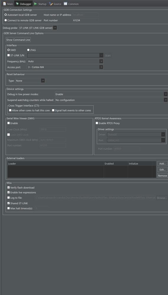

Hi Imen, this is what I have for CM4 and CM7.
The only way I can have spi running is if I run both cores at the same time ( I select both main threads to run) and then I can see the spi working on cm4. But my other issue is, I have a breakpoint on my cm4 code before calling spi, but when I click "resume" on both main threads, the debugger skips the breakpoint and proceeds with my code.
