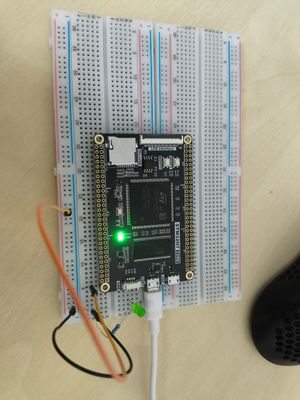

I just bought stm32 and i cant find any guides how can i enable led. I flashed pin PB7 so that it would output current

This is not an ST official evaluation board but it is a Board based on an STM32 MCU. So, you should ask the manufacturer of this board about the connections and the board layout.

You need to connect the LED so toggling the pin completes the circuit.
Any of these:
[PB7] --> [LED] --> [RESISTOR] --> [GND]
[PB7] --> [RESISTOR] --> [LED] --> [GND]
[VCC] --> [LED] --> [RESISTOR] --> [PB7]
[VCC] --> [RESISTOR] --> [LED] --> [PB7]Make sure the LED polarity is correct and resistor is sized such that the LED gets around 3 mA, or whatever the data sheet says is safe.
