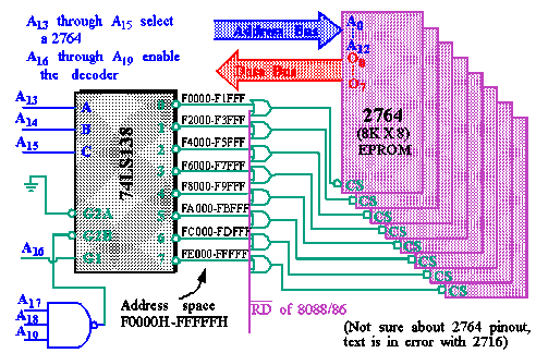

2024-09-06 3:32 AM - edited 2024-09-06 5:08 AM
@kazutobi wrote:
The SRAM I'm trying to use has two chip enable terminals.
I was thinking of doing it without a decoder. I don't know if that's possible though.
Two chip enable is to enable the memory itself. You need to use one and fix the another. You need as @Tesla DeLorean said an address decoder like the old TTL "74138" to address 8 memories. Each 74138 output will drive a chip enable of a memory. The address decoder is driven by the Higher address lines.
This is an old concept. So for example this link: https://ece-research.unm.edu/jimp/310/slides/8086_memory2.html
