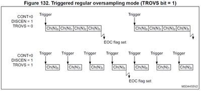

I'm looking for a way to configure multi-channel ADC sampling with different triggers for each channel. Currently, I can only find trigger settings for the entire ADC module. I came across triggered regular oversampling mode shown in below, but it appears to be for each bit conversion rather than each channel conversion. Is there any way to set up multi-channel ADC sampling with different triggers for each channel, or do you have any guidance or suggestions on how to minimize the impact of switching noise on ADC conversion?

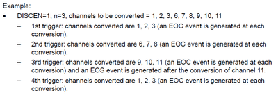

2023-10-18 5:01 AM
How about using ADC in Discontinuous mode and set the n = 1?
RM0440, rev.7, section 21.4.20, p.629
