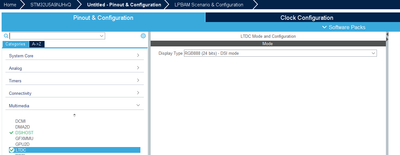

I am playing around with some STM32CubeMX configurations for the STM32U599/U5A9-series, but I can't find any options to configure the display DSI-interface, only LTD RGB/parallel.
Are there any prerequisites that needs to be configured first in order for the DSI-option menu to show?

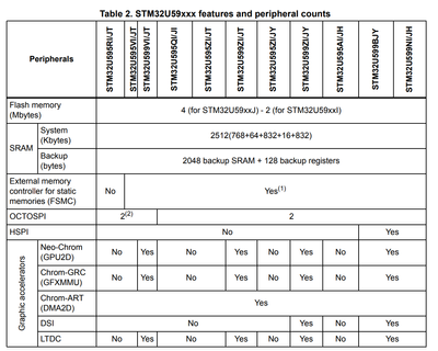

For the STM32U5x9, the lowest pin package can support the DSI is 144-pins.

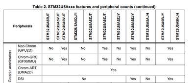

As already mentioned to check the availability of DSI feature, please refer to the datasheets DS13543 and DS13633 table 2.

Note that this DSI feature is not available in all STM32U5x9 MCU package, please refer to the datasheets DS13543 and DS13633 table 2.
If the DSI is available you can configured it as shown in the below figure:
Thank you.

The STM32CubeMX6.9.1 and DS13543 are correct. The bug is in STM32 MCU product selector - STMicroelectronics web site.
The The DSI feature isn't available in STM32U5A9VJ MCU.

Does this mean the lowest pin-count for DSI-support is 144-pins?
2023-09-12 1:10 AM
Hello @Southbranch ,
