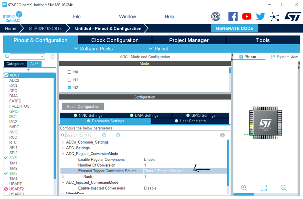

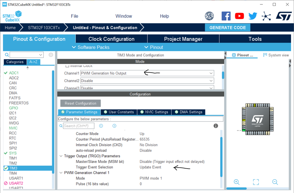

Hello @Sudhakar.R
Change to Timer 3 and follow this configuration instead
PWM generation doesn't need any output since timer is triggering ADC internally.
Trigger output event set to Update Event so that event every time the timer counter reaches ARR. Also, you should adjust counter period depending on sampling frequency and the application requirements.
ADC should be triggered by Timer 3 trigger output event (For that reason you need to change to TIM3)
You don't need Output Compare 1 mode in this application.
Hope this helps

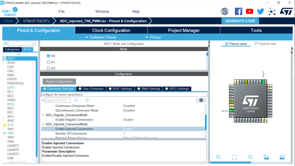

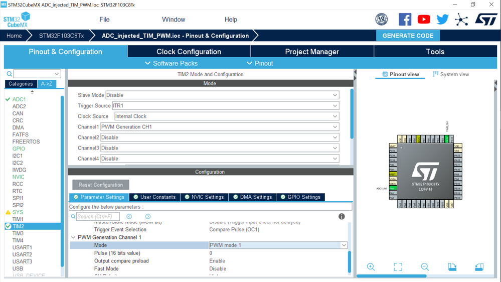

Hello @Sudhakar.R
Maybe you should start by exploring the provided example of PWMOutput.
Then, get inspired by the example provided of ADC injected conversion. You may refer to RM0008 section 11.3.9 Injected channel management Subsection Triggered Injection for the configuration.
To do so, you may start the configuration on CubeMX, to enable the ADC injected channel using TIM2 PWM. Here is an example :
Then conversion results could be read from in the ADC_JDRx registers.
Hope this helps.

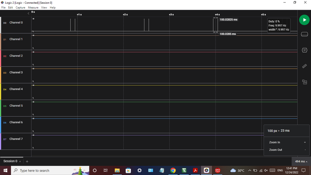

2022-12-26 4:29 AM
Hello @F.Belaid
I am using one regular ADC channel and one Injected ADC channel with PWM using STM32F103C8T6. but I getting regular and injected ADC values only and PWM is not generate. below mention my code and output image.
This is my code,

i don't know where i mistake. if you know help me.
This is my output image,
