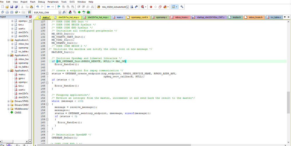

This code I have copied from \STM32Cube_FW_H7_V1.9.0\Projects\STM32H745I-DISCO\Applications\OpenAMP and pasted in both cores ,But I am not getting any response from cm4.
Please tell me if there is any changes to be done in code for getting proper output.
