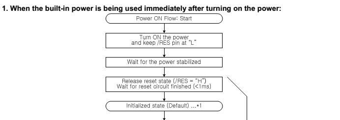

I'm NOT sure the
reset pin
is
the problem but from the LCD controller manual (Ver1.5 pag.51)
Looking at your
code
I
have a doubt
Have you addedRCC_APB1PeriphClockCmd(SPI2_CLK, ENABLE); ?
You use SPI2 and ask for APB2 but SPI2 clock in STM32F4 is APB1
the clock value depend on clock peripheral configuration
Internal oscillator or esternal crystal ? if external value ?
