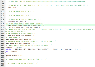

I'm implement IAP in Nucleo-H745ziq.
So. when i into application then cm7 trigger(boot) to cm4.
cm4 can't boot in keil but in stm32CubeIDE can boot.
SET_BIT(RCC->GCR, RCC_GCR_BOOT_C2);

2024-05-09 12:27 AM - edited 2024-05-09 12:34 AM
This doesn't work either.
I'm check already flash cm7 boot addres
HAL_RCCEx_EnableBootCore(RCC_BOOT_C2);
STM32CubeIDE Application Projcet it work cm4
But keil Application Project can't boot cm4

2024-05-09 12:48 AM - edited 2024-05-09 12:49 AM
STM32CubeMX 6.11.1
uVision 5.38
STM32CubeIDE Last Release
I'm make a IAP for cm7 and cm4
I wish BOOT_CM4 disable. and When jump Iap to Application then Trigger for cm7 to cm4.
I'm moved stm32CubeIDE to uVision. but already can't cm4 boot.
uVision(Application CM4 main.c) Can't boot cm4
stm32CubeIDE(Application CM4 main.c) Can boot cm4

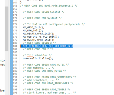

2024-05-09 8:21 PM - edited 2024-05-12 5:16 PM
I'm tried again Today in STM32CubeIDE.
First. I'm made new Application Project.
CM7 in main.c I'm code just one line SET_BIT(RCC->GCR, RCC_GCR_BOOT_C2);
But I can't boot cm4.
However, I'm tried Changed CM7 timer TIM4 from SYSTICK
Then CM4 can boot.
You know why that worked?
Now, My Keil application project can trig boot for cm4
