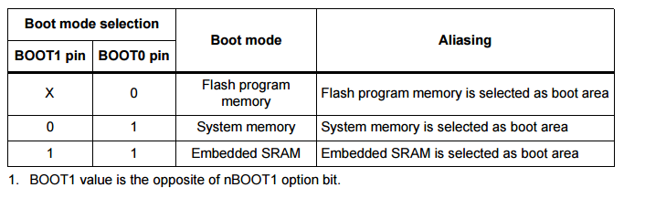

Hi Alexey,
Below is the ''Boot modes'' table(extracted from the reference manual)
As you may see, the BOOT1 value is the opposite of the nBOOT1 option bit.
If this answers your request, please click on correct
Khouloud.

Ok, I have seen it in Manual. But I didn't understand, how I can switch nBOOT1 option bit. Were is this bit? How I can to reach this bit? May be, in programmer (debugger) software? Of course, I must use setting of this bit before programming of STM32. In other case the code of the program does not fall into the right place!
I use ST-Link v.2.1 under Eclipse Luna from AC6. How can I manage this bit?

Hi Alexey,
back to your original question on how to set BOOT1 - this might be useful for other devs as well, since the doc is somewhat ambiguous.
(1) In principle, all you have to do is write to the option bytes at 0x1FF80000 and 0x1FF8004 with the values 0xFF5500AA and 0xFF8F0070, respectively. Here, the complementary bits 31-16 of bits 15-0 are already been taken care of.
(2) For security reasons, the options bytes are locked by default. To that end, first unlock FLASH_PECR register (clearing its PELOCK bit) by writing 0x89ABCDEF followed by 0x02030405 to FLASH_PEKEYR. Now you are allowed to clear the OPTLOCK in FLASH_PECR by writing values 0xFBEAD9C8 and 0x24252627 to FLASH_OPTKEYR.
Finally, you have write access to OPTIONBYTE1 and OPTIONBYTE2 to perform the task explained in (1). It is recommended to execute this routine from RAM.
You may verify your work by reading FLASH_OPTR, it should change from reset value 0x807000AA to 0x007000AA. There, nBoot1 = 0!
