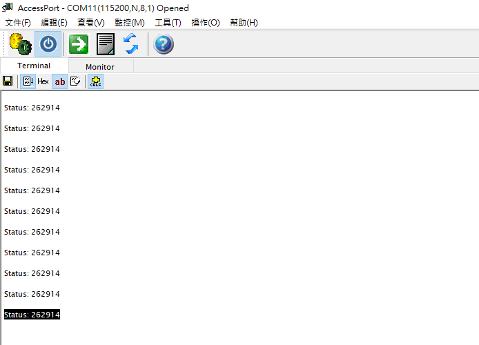

}// I sent SPI_data[4]={0x01,0x02,0x03,0x04} through stm32f407 (master)
// esp8266(slave) debugging return from Arduino
// Nevertheless, the result i got is {0x00, 0x04, 0x03, 0x02}

The code you're using to send SPI is fine.
The bytes are reversed because the Arduino stores them blindly as they are received and then reads them back in little-endian.
i'm pretty sure the first byte (0x01) is lost because it indicates the status register, although it's quite hard to trace the logic in the Arduino code.

2021-01-04 7:05 PM
Thanks , you give me a big hand.
