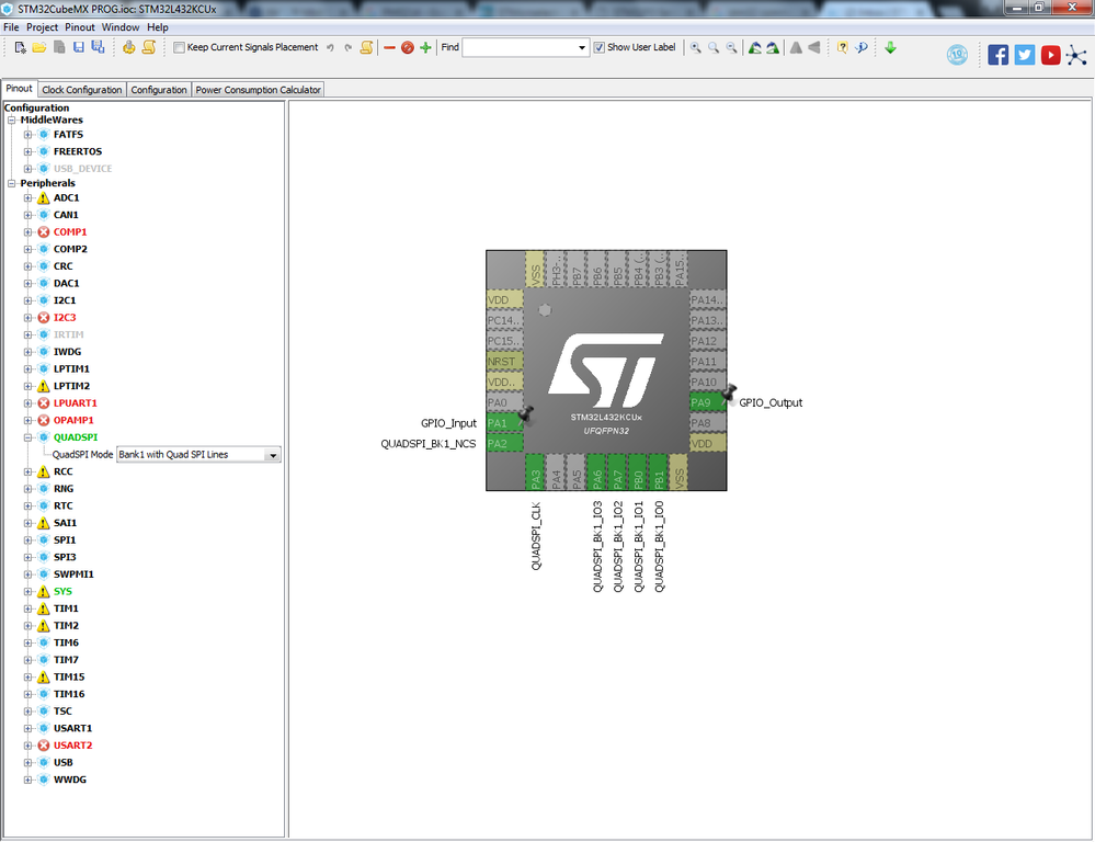

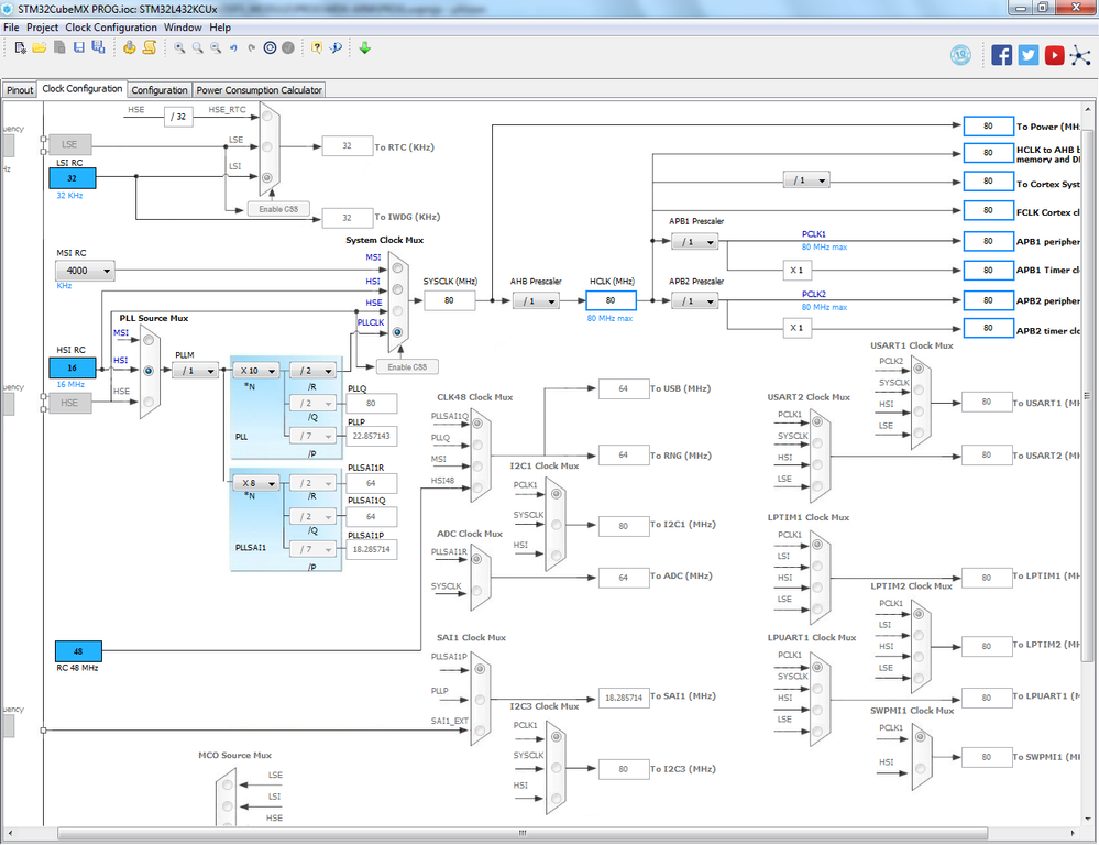

I AM USING SYSCLK = 80MHZ
AHB BUS CLOCK = 80MHZ
PRESCALER FOR QSPI = 0
and i am getting QSPI CLOCK FREQUENCY to 8 MHZ
i am using STM32L432KC controller.

Have you confirmed 80 MHz via MCO(PA8)
Perhaps show initialization code
