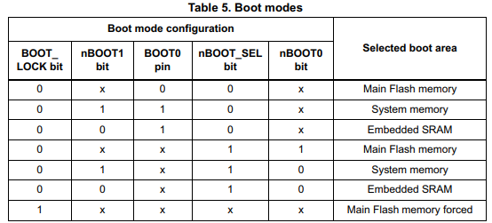

To expand on my question, I am also looking at the STM32G071 as another option. This also seems to have many option bits that need to be set to be able to program the device. The table from the STM32G071 reference manual has the following table for accessing the bootloader. (see image below)
My main goal here is that a UART-connected device can trigger a firmware update. The system should also allow for a device to be recoverable if a previous firmware update failed. I can add additional hardware pins to get this working.
How could an externally connected MCU be able to do a firmware update to this device without the need for any additional hardware (just GPIO being set high/low and a single UART communication)
You need a connection to BOOT0 and NRST in general to set it in bootloader mode, after which you can communicate via UART.
Some chips/families can overwrite the BOOT0 pin setting with an option byte so the answer will depend specifically on the chip you select, but that's one possibility. In general you do not need to write/modify any option bits for this to work.
