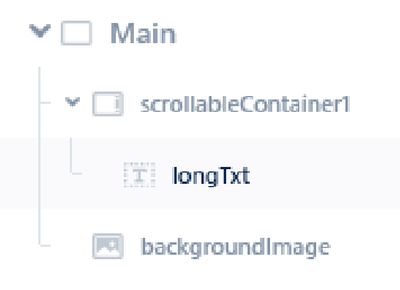

And your ticket ask image scroll, but backgroundimage isnt part of container here

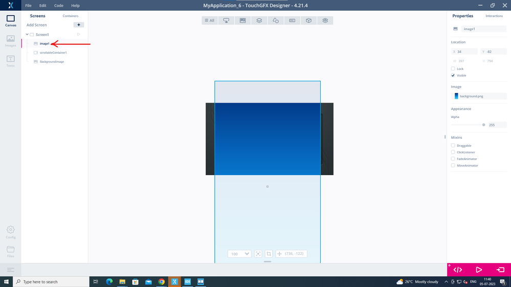

Hello @MM..1
Yes, I need an Image to be scrollable, but how the image is added in the Scrollable container, like in the example longTxt is in the part of scrollableContainer1.
2023-07-04 11:40 PM
Simply when you place red arrow click mouse and hold ... drag to any other level in tree
