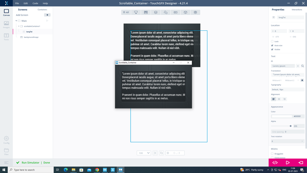

2023-07-02 10:48 PM
Only some part of the text is able to seen in the Scrollable Container(i.e. static one)
But scrolling is not getting to see the entire long text that I have added in the Scrollable Container.
I am attaching a screenshot from touchgfx panel.
2023-07-02 11:54 PM - edited 2023-07-02 11:56 PM
Seems you import example code and all is OK. scrolling is initiated with touch or in simulator with mouse drag...
And image isnt part of scrolling container then not move...
