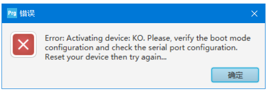

The booto now is 1,but it still show this error:
2021-03-01 2:06 AM
What error ?
2021-03-01 2:19 AM
The below:

My configuration as below:
Boot0=1,boot1 not configure
USART1
8-bits, even parity and 1 Stop bit
could you help to confirm boot1=0 is necessary?

This is what section 27.1 of AN2606 is saying: "The STM32F401xB(C) bootloader is activated by applying pattern1"
If I remember well, if boot1 is pulled to 1, the MCU boots from RAM.
