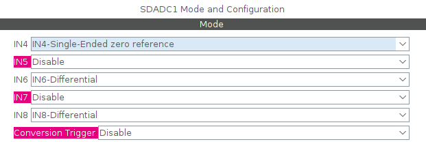

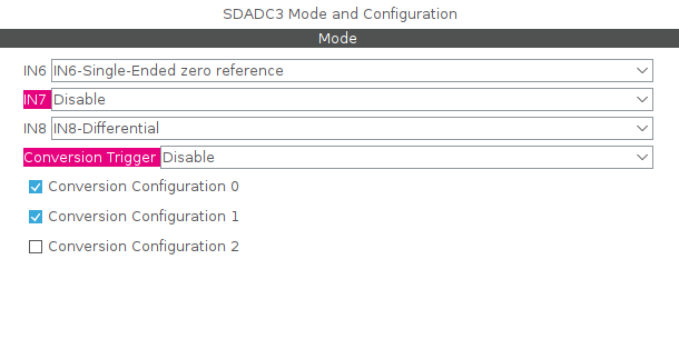

First I have these SD-ADC channels.
SDADC1 have:
SDADC3 have:

Yes, it works. But I have 5 measurements, not 1 measurement as the example shows.
I have created a call-back function for the NVIC interrupts for the SDADC's.
But still, I cannot get a stable value, because I'm indexing in wrong channel. Do you know how to do this?
Should I start with
CHANNEL = 0;Or what should I do?
