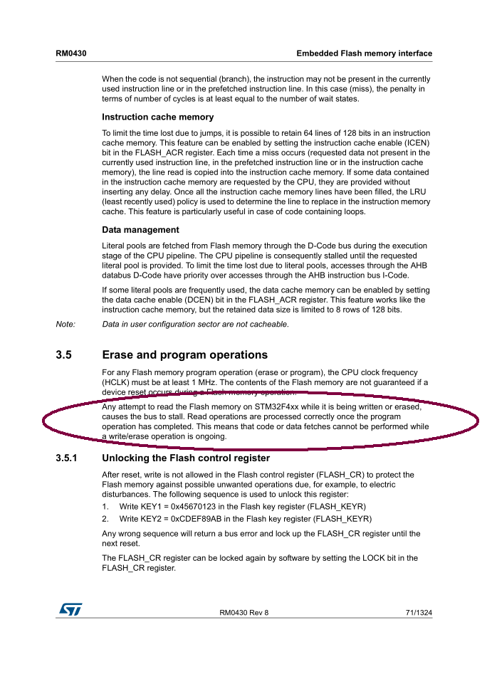

> You can read and write to flash at the same time
Well, you can't.
> the CPU may stall a few cycles
Typical word programming time of 'F413 is 16us (max. is 100us). At 100MHz system clock, that's 1600 cycles. I personally wouldn't call that "a few".
