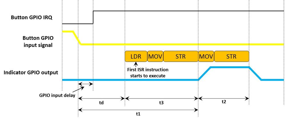

below picture is from (https://www.nxp.com/docs/en/application-note/AN12078.pdf) that shows the measure of edge to IRQ.
So, what about this parameter in STM32F3? How manny cycles cost before main process be suspended/halted? (or said how many cycles from edge to IRQ?)

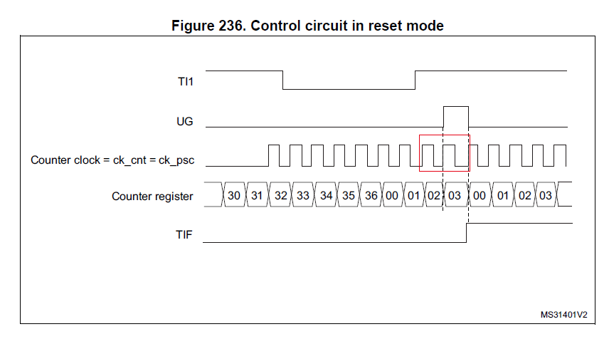

> How does the external signal trigger DMA? EXTI can't directly trigger DMA. Through a timer capture channel?
Yes, the exti pin also is configured as timer ETP pin, trigger UEV by edge and send a DMA request same time.
From the edge to DMA transfer trigger, it's two clocks need(Timer works as system frequency):
And with another 2 clock for DMA arbitration, the DMA will read data at next clock. so, there will be 2 + 2 = 4 clocks from edge to DMA read data. I have to make sure CPU is suspended at 5th clock(I could add external trigger filter argmuments to increase the detection clock).

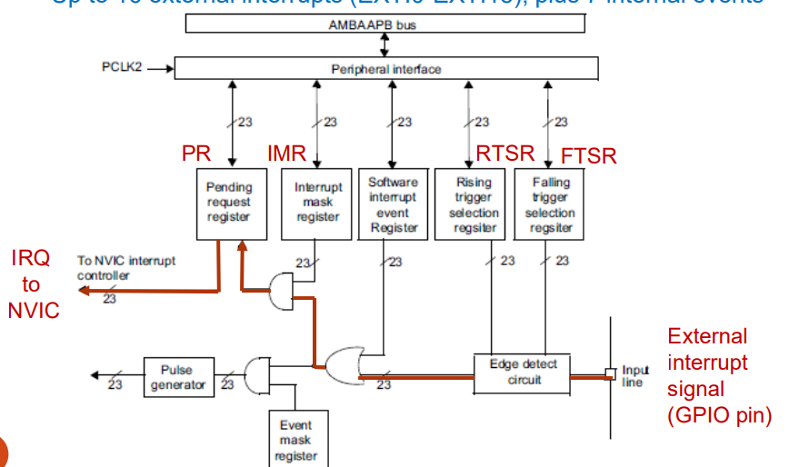

There will be a synchronization time(or detection time) from edge to suspend CPU, but I think it's not for finishing the currently executed instruction, but for edge detection and NVIC, 2 cycles maybe right, but I need a exactly right number for security.
I tested 14 to 16 cycles from edge to the head of first interrupt instruction execution(Run in CCM RAM), told me that 2 to 4 cycles maybe are the result, but it don't match fixed 2 cycles, make me confused, so wanna figure out the real cost in theory.
Is there a document show the detail when EXTI to IRQ?
2020-04-05 7:00 AM
I haven't found, but it doesn't mean that there is none. EXTI reaction could be delayed by 1 to 3 cycles as well, bit I don't have any definitive source on this.
The external trigger could come just a nanosecond before or after the system clock edge, and after 2 cycles of propagating through EXTI, it could hit either a 1-cycle or 2-cycles instruction. But this is speculation too.

Also, EXTI in 'F3 is on APB2, and I wouldn't be surprised if there would be an additional synchronization delay between EXTI and processor/NVIC, possibly dependent on APB2 prescaler (potentially causing jitter in the latency).
2020-04-05 9:02 AM
You are right, but the edge to interrupt needs propagation through edge detector/NVIC, that will cost extra cycles.

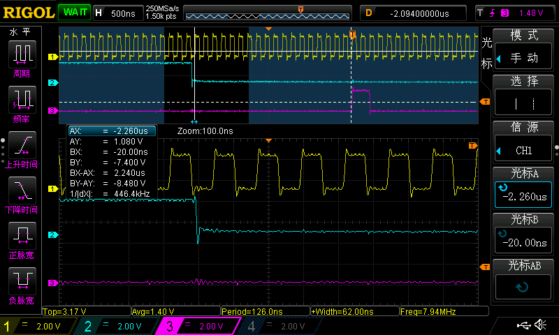

After I reuce Core clock to 8Mhz and test, I get constant about 18 cycles(2 exti propagation + 12 interrupt store + 4 insturction cycle)
Channel 1: MCO, clock output
Channel 2: Btn, detect on falling edge
Channel 3: GPIO, set in EXTI interrupt routine
I think my previous error was caused by MISMEASUREMENT, it was much easier at low frequency.
