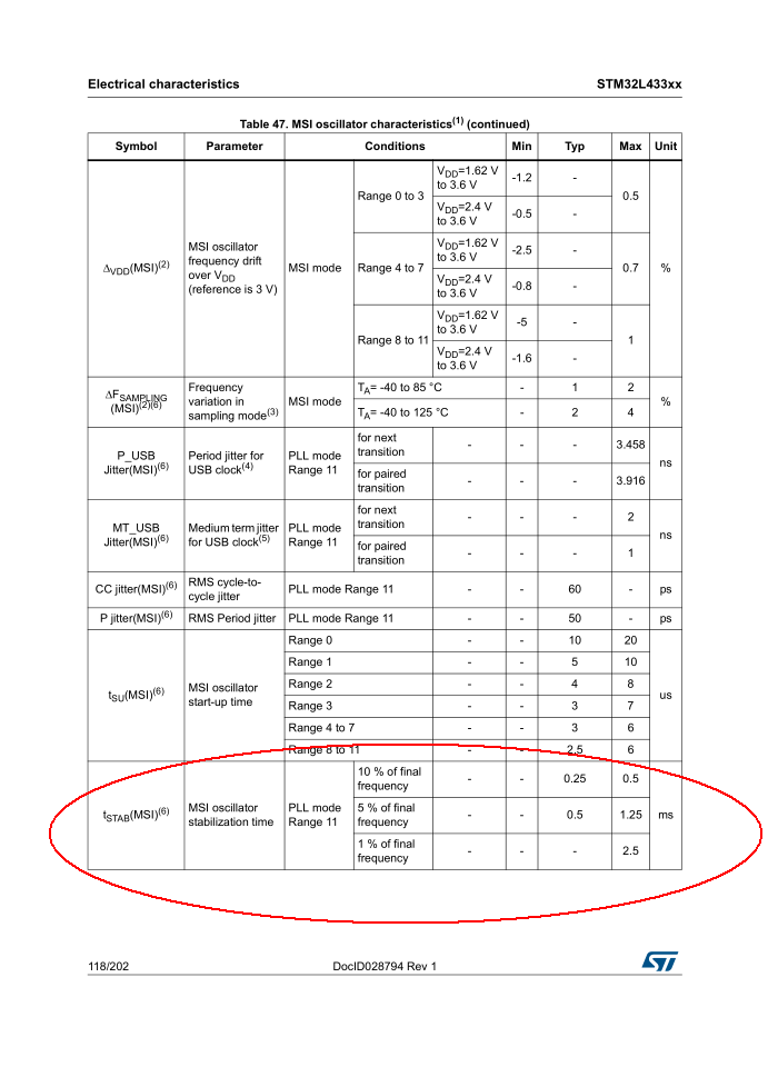

This is for 'L433, look in to DS for your device:
2019-09-17 4:40 AM
JW,
Perfect! Thanks a lot. The L432 has the same entries in its table - which I never even thought to look at!

IMO the MSIRDY flag indicates stabilization after switching MSI on, i.e. is related to the tSU(MSI) parameter in the table I posted above; rather than to the stabilization of the PLL locking MSI to LSE.
