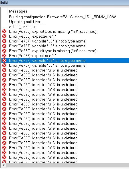

The error(s) are actually about variable types being undefined: u8, u16, etc. These are all defined in stm32l4xx.h, so I deduced that's not being included. That header gets called out in system_stm32l4xx.c. system_stm32l4xx.c should actually have about 30 header files under it in the project tree if it was being included properly. I have none.

It's going to be easier if you show the exact error message.
2021-08-24 8:51 AM
Here's some of them.

https://github.com/STMicroelectronics/cmsis_device_l4/blob/master/Include/stm32l4xx.h
As you see, stm32l4xx.h does not define types "u16", "u8" etc. It rather uses stdint.h.
Also, system_stml4xx.c does not include a lot of .h files.
Confused? the messages come from compiling some other .c file, not system_stml4xx.c
2021-08-24 11:23 AM
Sure looks like the error messages are from "adjust_px5000.c" and not from a system startup file.
