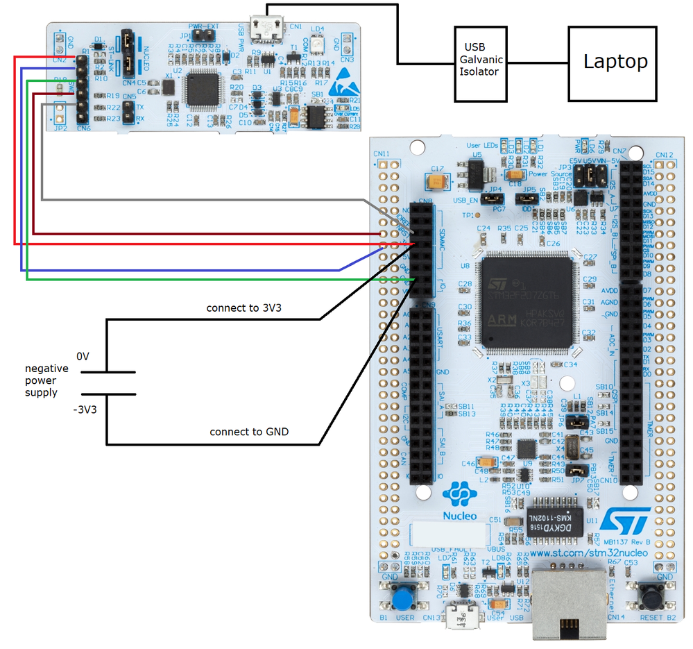

Voltage is relative. As long as VDD - VSS = 3.3V, it will work. However, if you have other things connected to the board that think VDD = GND, you're going to have issues.
Information on powering the board from 3.3V is in the user manual:

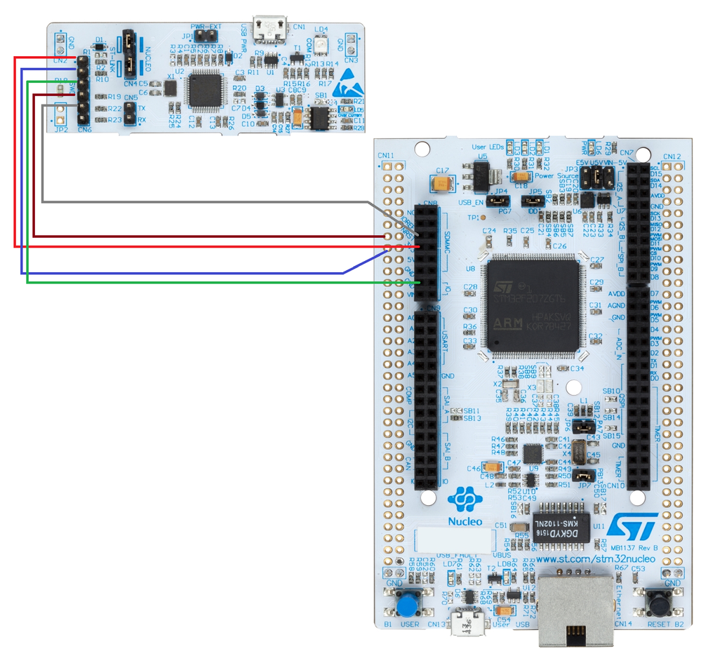

According to Table 7 (page 19) and paragraph "External power supply input: + 3.3 V" (page 23), there are two possibilities:
- ST-LINK PCB is cut
- SB3 and SB111 OFF (ST-LINK not powered)
So my question is: If I cut the ST-LINK/V2-1 PCB from the board, is it possible to use the ST-LINK/V2-1 (removed) to program and debug the same board (I removed from)?
According to Table 5 (page 22) and STM32CubeMX:
VDD_TARGET --> 3V3
SWCLK --> PA14
GND --> GND
SWDIO --> PA13
NRST --> NRST
Is it correct to connect the pins as shown in the picture?

I made the connections as shown in the picture. LD4 and LD6 are turned ON.
I tried to run a test program on the board.
I chose the "GPIO_EXTI" from the repository (..\STM32Cube\Repository\STM32Cube_FW_F4_V1.25.2\Projects\STM32F429ZI-Nucleo\Examples\GPIO\GPIO_EXTI).
After running the program, the microcontroller fails on "HAL_RCC_OscConfig(&RCC_OscInitStruct)".
The same problem if I choose another example from the repository.
2021-06-21 7:14 PM
The clock source used in that example (and probably others) comes from the ST-Link, which you've cut off, so no clock source.
You'll need to modify it to use the internal HSI instead.
