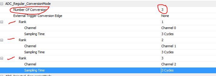

If I understand well your problem, you are not , in fact, enabling the channel you just select the ADC pinout. To enables several channels in CubeMx you should increase the number of conversion and select a channel for each Rank, as shown in figure below:I have reproduced the case and I share with you the .ioc file (see attached)
-Hannibal

Thank you. I see ADC channels now.
Clive1, if you asked for some code, there was no code from myself. All I did at this stage was to read the files and trying find out how to do things. Hannibal, you guessed correctly, I did not notice the tab in the Cube tool. Your .ioc file is much better. I have just started to study the code and I have a few questions, please. In this configuration, all the enabled channels are now read, one after another? Do the polled functions work correctly. Life is easy if you have a single channel only? I have tried a single channel ADC with polling methods. What is the best way to study DMA or interrupt driven conversion? That is, I need to know what is the conversion result/buffer data size (32bits?). How do you know the number of conversion rounds? Regards LeifWe’re moving the ST Community to a new platform to give you a better and more reliable community experience.
