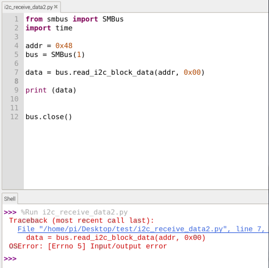

#endif /* USE_FULL_ASSERT */Ive an array int msg[5] = {1,2,3,4,5}; that i would like to send trough the I2c port in only one try but my code dont seem to work...

2022-03-23 6:56 AM
I start my STM32 program and once its running I start my python program who reads a block of data. But it gives this error code
2022-03-23 7:17 AM
There don't appear to be issues in your STM32 code.
Put a logic analyzer on the signal to see if the RPi is sending the correct data. Verify external pullups are present and hardware pins are connected correctly.
2022-03-23 9:23 AM
The usage of msg and buf arrays shows a complete lack of understanding of the basics of C language and data representation in memory. Start with learning that...
