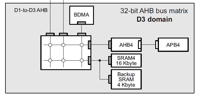

Want a 16-bit write to ODR, or 32-bit to BSRR, would suggest the latter as you can pick the pins you want to leave an those you want to touch.
Seem to recall the GPIO is on AHB4, so perhaps SRAM4 via BDMA
