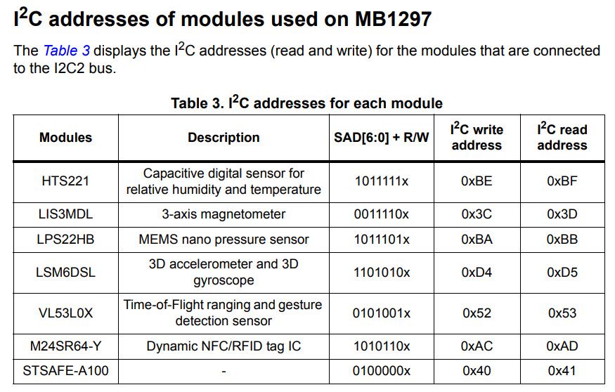

Is there any further explanation how to communicate with those modules in source code?
Thank you very much in advance.Suryadi
